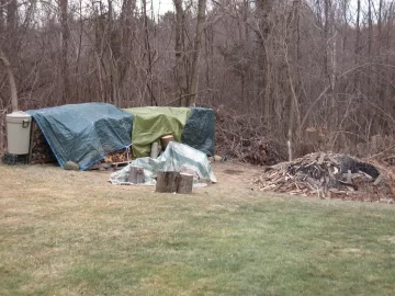

    Yep theres your problem right there under them tarps since 2008 you never read any post here about covering or not covering your wood.

    Stanley John , think of it this way , you take a damp towel ,put it in a zip loc bag . It will not get wetter , but it will also never really start to dry out either. Basically , you need air circulation to carry away the moisture .

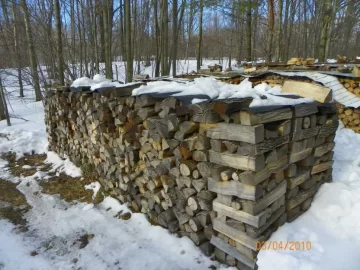

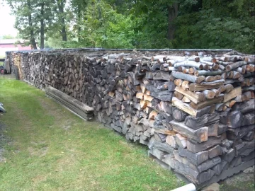

    Stanley, don't worry too much about stacking the wood in the sun. Wind will dry the wood much faster than the sun will. Also having oak, I would stack in single rows.
    Here is basically how we do it. Our cutting time is getting near as we usually start around December 1 and continue off and on until March. We stack up the wood in the winter wherever we want the new pile to be. After snow melt we split all the wood. Immediately after that we stack it. Under the wood we lay down some poles, saplings that we cut in the woods. This keeps the wood off the ground and gives a little air circulation there.
    That spring, summer and fall we do not cover the wood. We do top cover usually just before the snow starts flying decently and use old galvanized roofing for the covering. In October we move enough for the winter's supply into the barn so we don't have to dig wood out from under snow. However, the wood we move into the barn has usually been sitting outside in the wind for 3 years or more so we know it is dry. In addition, many times we've stacked wood in total shade and have never had a problem with drying but would not do that if we needed the wood right away.

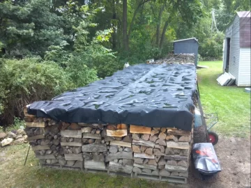

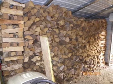

    I usually only topcover the wood I plan on burning in a winter the summer before. All of my wood is seasoned at least three years minimum, two years without any covering at all. Do not cover the sides, you really need that air to travel through the stacks......and like Papadave and others have said, get as far ahead as you can. You never know when something comes up and you can't get wood for a season. I have around 25 cord on hand, plan on getting more when I get a woodshed built. My limit here at the house will probably be around 30 to 35, which will easily get me through 5 years.
