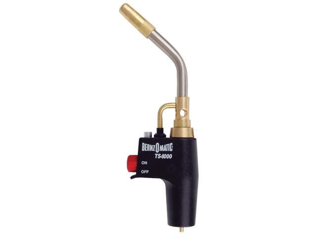

I used one of those Bernzomatic TS4000 push button stater ones.

I lit my EF-2 for years with a torch. Works great. Takes less than a minute.
[Hearth.com] Starting stove w/ blow torch??
Start stove.
Handful of pellets in the burnpot.
Hit with the torch until burning well.
Close door.
Enjoy heat.
---Nailer---
Does it work w/ propane or do I have to use a hotter gas??
Propane works for me!
