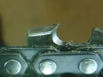

30 rc is like stihl 33rs its full chiesl ready to rock....full comp all around chain its my favorite price and its good chain
ripping chain is better with semi chisel it will stay sharp longer. non safety 30scs

thats cut at 30 degrees to make it a ripping chain you just change the angle to 10 degrees and that chain is the woodland 30rc series and rakers need to be dead on.

Great thanks for the pic's,,
Now I'm gonna show off some of mt noobness...
Ripping chain better fo noodleing or just better all around???

better for stumps even in if your cross cutting the grain in the wood is a lot different at ground level. oh lets see the oddels of noddles...
