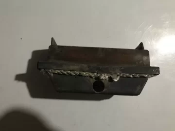

Stopped heating with a crack pot! See pics

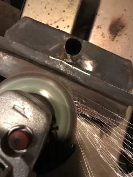

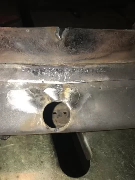

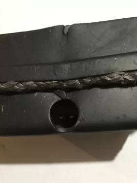

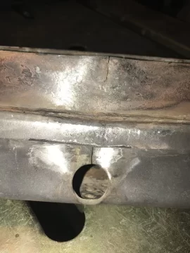

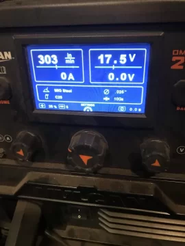

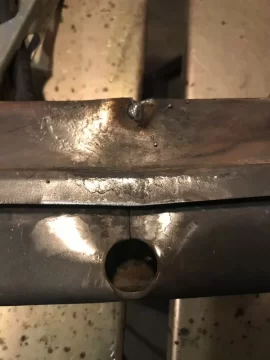

It has been a few years and these cracks can only get worse, So I just pulled out the grinder and Vulcan Mig, ground it to clean it, zapped it, ground the weld down, painted it and put in a new flange gasket. Hope that will preserve it? How does it look?
See the pics

Looks good to me Don, if the fitment works I say well done, I have yet to weld anything on a stove....luckily
Mine is stainless (pot) so a few years back, I TIG welded a crack and so far holding up just fine.
Cool, did you use straight Argon gas and stainless rods?
