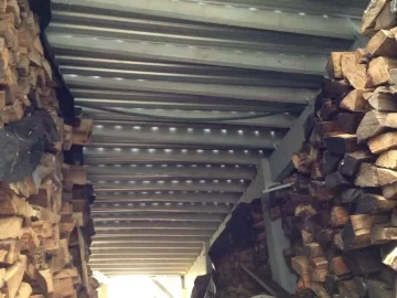

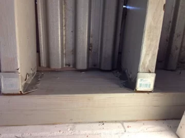

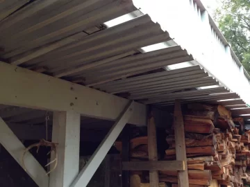

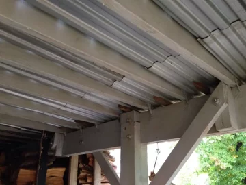

I did this with corrugated metal sheets.
On a 12' wide deck I used an 8' and 4' sheet. Used lobbers that ductwork subs use to rip the 21" sheets in half so the edges aren't jagged. Screwed the 8' sheet at the house to the bottom of the deck board (making sure the screw is shorter than the deck board).
The 4' sheet overlaps at the outer edge.
Used some scrap wood to shim up under this overlap for constant slope.
The joists are 12" oc instead of standard 16" oc because of plastic deck boards, so the 10 1/2" sheets fit pretty well, though there are some drips that get thru.
I'm thinking of using some 3/8" backer rod 3" long between the deck boards, above the joist to channel the drips into the metal sheets.
