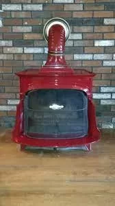

Here's one of the few videos I was able to find about the VC Dauntless. It was posted last year and that seems about right for how long it's been out. VC made a stove in the past that was also the Dauntless but very different from this EPA certified version.
And here's a photo of the original style Dauntless stove:
Reactions: jasejase
