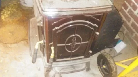

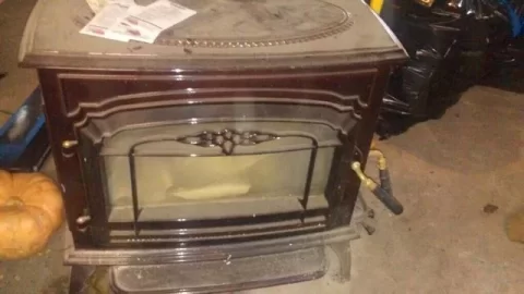

Considering buying this from a family member and making it a hearth stove.
I can't quite get them to figure out where the plate on the back is...
Any ideas?

I'm not an expert but it sure looks like a Quadrafire Yosemite (which I have).
I'm sure someone more knowledgeable than I will chime in shortly.
Best wishes!
Bob
I agree. Quadra-fire for sure.. how much? I'd say $1200?
