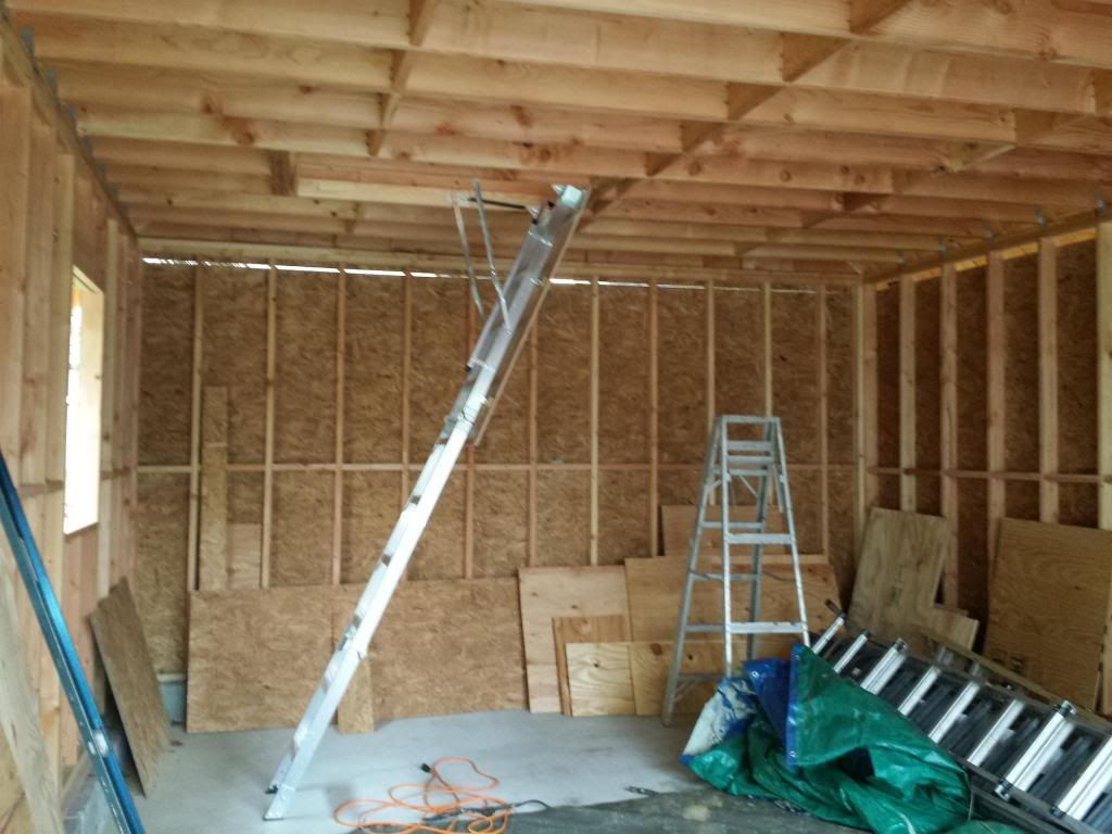

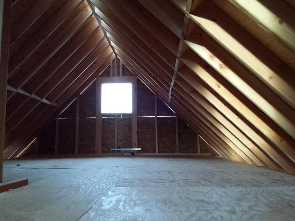

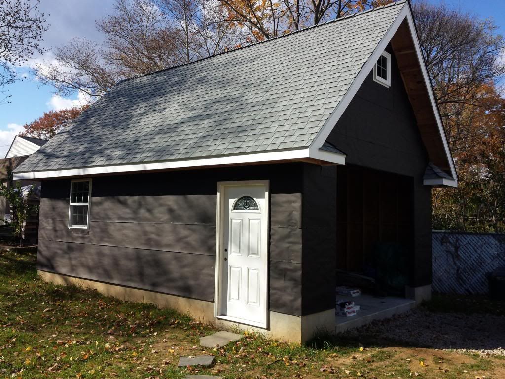

I plan on spending a good amount of time in there. It's not completed yet, still need to install the siding and soffits on the outside. The inside will be fully insulated and drywalled this winter. If I was going to put a stove in it, it would be before I started working inside which should be within the next month or so. Should have the outside completed in 2 weeks.
[Hearth.com] Stove in the garage, need suggestions
Reactions: loon
Very nice, stove would go good in there.
Reactions: Keyless Chuck
Wow, that's nice.
