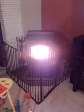

Well, I'm not sure what fixed it. Was it a potential pellet clog when I cleaned out the hopper? Or was it the fact that I didn't properly latch the hopper, which I guess won't allow the distribution fan and feed to proceed? I hate my life.
It's burning now. I certainly have a lot to learn and will have them take care of the draft voltage when the come back to complete the OAK install. I'm going to bed. :)
You all have been extremely helpful (and patient) throughout. A really great resource.
