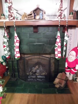

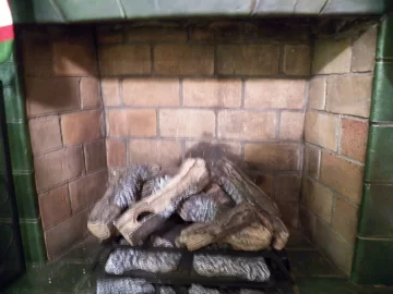

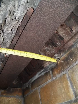

I'm so thankful for how helpful you all have been. I hope to someday have as much knowledge and be able to pay your kindness forward to others who need the help. My question is this....I'm checking out a stove with a rear flue which is 28" to the top of the flue and our fireplace opening is 29.5" tall (attaching pics to help with the visual). We would have to set the stove on the hearth then extend it to match the required clearances then run an elbow out the flue to go up the chimney. Here's the thing that has been giving us trouble the entire time we've been trying to figure something out (several weeks now)...The opening between the lintel and the back of the fireplace is about 5.75" so we were going to bring the flex liner down into the fireplace opening then attach to the appliance connector then attach to a stove. It is proving extremely difficult to find a stove that is short enough to allow the room needed to attach to a connector then to the flex liner prior to entering the chimney. So can we make regular stove pipe fit through that 5.75" opening (like using a vice or something to just compress it a little)? We are trying to avoid messing with the brick in our antique house and I know messing with the lintel is out of the question so IF we can fit that stove pipe up past the tight spot and then connect to the liner we would have SO many more options. Is this doable? And again, thank you so so so much!!

Why not squish, or "ovalize" the bottom end of the liner to pass by the narrow damper and then connect to that? It will be easier, more practical and arguably safer to have any stovepipe connection inside the fireplace opening rather than out of sight above the damper. Stovepipe wont last as long as the liner. If it is connected blindly to the liner, it would be damn difficult to see how the stovepipe is wearing. Also, it is best to have a mechanical connection of all pipe joints, i.e. screws or clamps. making that connection up above the damper would be a challenge. I make all these points because I have a similar situation. To accommodate my stove`s flue collar height, I had to remove a brick, nibble out a bit of the lintel (i realize you do not want to do disturb your fireplace). I also had to bash my tee in a little to make it through the damper frame.

I've looked inside many hundreds of fireplaces and can't tell what is above the damper throat. Is that the damper plate? Anyway, call a local dealer who sells Olympia chimney liners and order a 7" flex liner kit with insulation. Have them ovalize the bottom 4' of flex and build a custom cleanout tee that accepts the ovalized flex and has a 6" take off the length you need to plug into the stove. Also look into upgrading the top plate/cap assembly to the terracotta mount cap for your size flue. It will look much nicer. (broken link removed)

Ok, the best way I can think to explain it is if the top of the flue opening on the stove is 28" and the top of my fireplace opening is 29.5" I only have 1.5" til pipe is going up into the lintel opening. I can't think of a way to bring the liner down into the fireplace opening and elbow the stove pipe up and fit all that into the 1.5". That's so hard to explain. Does that make sense at all?
Don't use an elbow, use the tee in the above post. This tee will have a hose clamp connector at it's top. You will drop the ovalized flex through the narrow opening (this is why 4' is ovalized) connect the tee and pull it back up to the height to connect to the stove and trim off the excess at the top.
