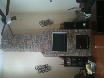

Do i need to use the double wall stove pipe in my attic? I know i have to use it through the ceiling and roof and 36" up outside roof right? But do i have to have it all the way through the attic? Also i have a fake stone chimney in my living room if i run the pipe through it does it have to be the double lines as well. I just want to be safe and also get great performance.
Someone also told me no bends in th pipe but i see many installations with slight bends. Any thoughts? [Hearth.com] Stove pipe question

What is confusing is the term double-wall. Forget that. What you need to do is to switch from connector pipe to high temperature chimney pipe (class A) the moment the room envelope is penetrated by the stove flue system. It's not clear what you are trying to accomplish with the existing setup. Could you clarify?
If the unit you show in the photo is a wood burning insert or if you plan to replace whatever you currently have with a wood burning insert you are going to have to get some sort of hearth extension for in front of the unit. To my knowledge, most inserts require 16" of non-combustible hearth in front of the insert.
Thanks guys. Let me clarify whats in the (sideways) picture lol it is real stone however just for looks. The unit in there is electric. I want to get rid of it and put a wood stove like the Lopi Liberty or similar in front of it. I would extend the stone to the floor to do this and close the tv hole, which is finished. I would then expand the old electric insert hole and finish with stone so i could "partially" recess the wood stove. I wanted to run pipe up through the fake chimney, through attic, through roof. Room is 18', attic 8'. Thanks and hope this clarifies.
well you need to follow the clearance requirements very carefully for the stove realizing that that framed wall with stone directly on it is not a noncombustible wall. And you cant run stove pipe single or double wall anywhere inside that chase it needs to be class a insulated chimney from the point that it enters the chase until the chimney terminates above the roof.
Please post a diagram that details out the plan. Specify what you mean by pipe. Doing this wrong could be unsafe.
When i said "double wall pipe" i was referring to class a insulated chimney, such as the ICC Excel or similar products. My terminology was wrong. I am new to wood stoves and have not purchased anything yet. Im not ignorant to the safety aspects and i wont do anything unless it is very safe and to code where required trust me.
