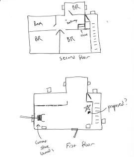

So back in the fall we moved to a 1500 sq ft 150 year old farmhouse.
There was a prefab chimney installed when we moved in but no stove. I had no wood and no sources for wood, so I didn't buy a stove for this winter, but now I am trying to get set up for next winter. To me, picking a stove is a secondary consideration to the hearth and flue, so I'm trying to get that nailed down first.
The current setup is an "out the window" in the spot shown in the pic. My wife wants the stove to go to the star shown, to get more usable space in the living room and regain the window that was walled in.
I said no way, but then I noticed there was a circle poorly plastered over in the ceiling at the proposed spot which indicates to me at one time there was a stove there so I thought maybe... so I would at least think about it.
Questions for the board:
1. Is this an equal or better location from a heating perspective for our layout? One guy told me he thought all the heat would just rise up the stairs leaving main level cold and top level too hot
2. Cost-wise, what do we think its going to cost to install flue through the second floor and then up into the attic, and then out a slate roof?

If the stairwell is open then yes, a lot of heat will convect up the stairway. A blower on the stove can help circulate heat better on the first floor. Normally my preference is to go straight up and out the roof, but the slate roof presents more of a challenge. Is going thru the wall at another location also an option, maybe on the same wall? Can you post a picture of the current chimney location inside and out?

I figured that heat would go up, but I looked at that as a good thing -- since we want heat second floor too, but I didn't consider would be enough to make the first floor cold. There is a door at the top of the stairs
I'll post a pic of the existing setup inside and out when I get home. We could definitely go out through the same wall its on now, but the stove would be just about in the same place possibly even worse from the wife's space/usability point of view.

I would wager if the stove was over by the stairwell (open stairwell?), it was moved because all the heat was going up stairs and not staying on the first floor. Who knows how long ago, or with what stove. Like begreen said you can get decent blowers now that can circulate heat better. I don't know much about slate roofs so I can't help you there.
So...
1) Currently it seems to be in a better location than near the stairs given the info provided.
2) Cant answer this without more information. Length of pipe, floor/ceiling pass-through( how many ), accessories needed like roof brackets and such, DIY or contracting the work out etc...
Betting the stove is where its at for good reason. The old stove location near the open stairwell would definitely not be my choice.

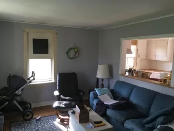

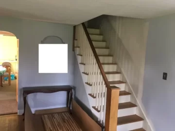

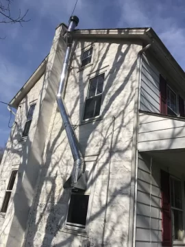

@begreen here are the pics, pardon the mess I am in process of redoing the kitchen. Standing in front door, looking left to the current flue location, then right to the proposed spot near the stairs (currently occupied by the butcher's block). Exterior shows the class a pipe up the side of the house. My intention would be to re-use this in the new setup. Yes, I am aware that the current flue setup is improper. That's another factor in why we didn't burn this winter
[Hearth.com] Stove placement in the home [Hearth.com] Stove placement in the home [Hearth.com] Stove placement in the home
Happy wife, happy life. Don't fight it, she's probably smarter than you, too. :)
Looks like hollow block construction? Even so, think convective stoves.

The door at the top of the stairs will provide control for upstairs heat regulation. A blower on the stove will also help a lot with heat distribution. As for the cost with a slate roof, I would just be guessing. With a conventional roof this might be around a ~$2000-$2500 install if there are no confounding factors and you DIY the second floor chase. All said, a happy wife may be priceless.
LOL - True. I had to look up what a chase was, That should be doable. I think I should be good to DIY everything except the roof, messing around with slate.. yikes.

After looking at your pics I would put the stove in that corner where the lamp and black chair are currently. Do a through the wall install.
You’ve already got the chimney running on that exterior wall. Would be the simplest option. Remove the two 45’s in the chimney, run it straight down, punch a hole through the wall, done. You already have 90% of the hardware where it’s already supposed to be. Would be a very easy, less expensive DIY job.
