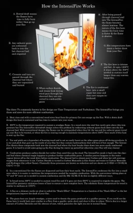

This is what he is currently using:
[Hearth.com] Stove required for "Wood Stove Design Challenge"
Here is his invention in action.

Here is some more info:
(broken link removed)
I could be missing something, but the concept looks somewhat like the old Vermont Castings horizontal burn system from the 80s where the flue exit was down low on the sides and fed the secondary burn chamber with its own separate air intake.
This is an add on device for older stoves. To make them more efficient.
It looks cool. Would it improve a new cat stove (such as a Progress Hybrid)?
If so, how much?
Also, can it work with rear vent, or is it designed only for top venting stoves?
The Progress stove already has a secondary air manifold built into them to inject pre-heated air into the smoke path to burn alot of the smoke before it enters the cat. But also at lower operating levels the cat is the main device that cleans up the exhaust as at lower settings the secondary air injection is not as effective. Thats why you can get longer burn times from cat stoves as they operate at lower input air settings for slower burns.
This device is an add on device is accomplishing getting you a secondary preheated air injection to older stoves that where not designed with it to begin with.
