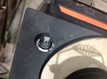

I don't want to hijack Bluedogz thread so I started a new one. I too have the same problem with coals building up (Going to get a rake like mentioned in his thread!), but I also have what some might consider high stove temps. Stove info is in my sig, I have a 20" rise out of my stove, a 90 and then a 30" run to dump it into my solid brick chimney that is lined with 9x9 clay fire tile. It was built in 1950(can you say brick s House) and is in perfect condition and approx 24' tall. I get great draft.
Now my stove temps, it sits in the basement and heats my whole 1200sqf house by gravity so I need it to throw,it's of heat. My stack and stove temp images are below. Best I have.
Because of the coal problem I was reading all the stickies and found out I have temps much higher than others, but as you can see in the pick it does not even look a little red, but man is it throwing the heat. -0.4f outside right now and the upstairs is 73. :). Should I be concerned about the temps? Anyone have this same stove and not have a coal problem?
Oh yea, hickory cut three years ago into 8' and then 18" CSS for 1 year.
  • [Hearth.com] Stove temp and coal build up
My Austral likes hot! Measured with an IR gun 650::F stove top seems to be where the Austral likes to be. I've seen 800::F briefly a few times with no hiccups I'm aware of.
Do you have a stove top thermo on your pipe? That seems hot, mine runs up too 500::F and then backs down to 300-350 when stove top is around the 600 mark. Have you hit your stove and pipe with an IR gun to verify your temps? I use my thermos as a guide line only as I find them, well, at best misleading at times.
Does the fact that your thermos are upside-down cause confusion? :p

It's not a stove top thermo, it is a through the pipe thermo. I don't have an IR temp gun. :confused:

Ahhh....if you have double walled pipe that explains the pipe temps indicated. As I recall from reading a few other threads, internal temps on double walled pipe usually are about double that of single wall with magnetic thermos. So, my 350 on single wall would be 700 internal, your 800 internal double wall would be 400.... I think,..... I've never used the good stuff. ;) You might want to do a search.
Your stove top looks high though. I've found the hot spot on my stove to be about 4 inches directly in front of the exhaust exit and use the SBI thermos as well. Mine read inconsistently all over the place, do you have another thermo you could try there?

Hmm not sure where I mentioned double wall... I have single wall cheap pipe cuz That is all I need. I looked at an IR gun today, they are spendy.
You didn't say double walled, I assumed it. Still, your internal temps are going to be much higher than those of a magnetic thermo.

Using a probe thermo on single wall pipe can make for some wonky temp readings. They are not really designed for the high surface temps the single wall is radiating to it.

All I can suggest is to get a magnetic thermo so you get a more accurate indication of pipe temps. Your burning as I and most others are, just remember, if pushing your stove in colder temps it will require a bit more babysitting.

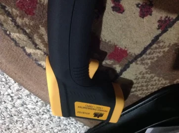

Stove top reads 578 and my pipe reads 380
