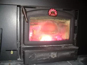

This fire look a mess. Please ignore the fogged up glass and the less than desirable burn. I thought a picture would help. I just snapped this and the temp was slightly above 400 Can someone, if this picture is clear enough, can tell whether the secondary is going or not. I'm not an expert but it just doesn't seem this way. Thanks again

Looks like there is some secondary burning happening. Not aggressive, but towards the back it seems to be starting.
bluefrier has a good point. If the ceramic baffle isn't tight to the back of the stove, the gases will take the path of least resistance a will shortcut up the back of the stove.

I'm lookin' at the pic....WHERE'S THE WOOD?????. I see a good coal bed....but there isn't anything sitting on that heap o' coals.
Right now, with that coal bed...if you crack the front door is it really suckin' the air like it wants to pull the door shut???
Yes...there is a vortex of air that gets sucked into the stove.
