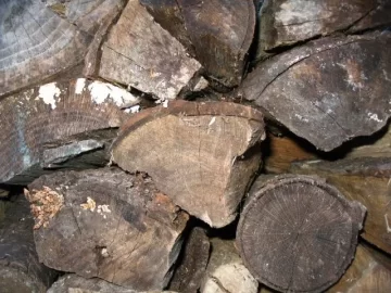

Here are pictures of my wood by request.

I was able to get the 450 degree with little ease too. I was not even tending to the stove obsessively like i am know. BTW. how does my wood stack up...does it look dry enough?
Looks pretty weathered...which is good.
