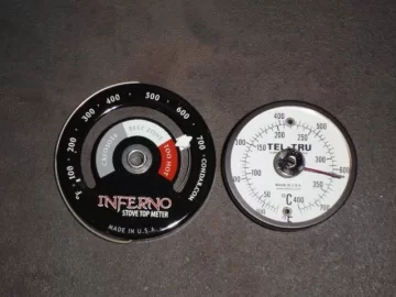

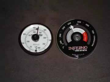

I don't trust the IR thermometer. I like it as a guide but it also seems to measure a wider sweep range of air. Intuitively you would think it is measuring the spot where the laser hits but that's not the case...
I have a Tel-Tru and a Condar. I've run them side-by-side and swapped them and the Condar runs pretty close. The differences you see in the pics were actual temp differences on the stove top and followed when I swapped locations. The Condar doesn't react as quickly as the Tel-Tru (especially on the way down) but I'd say it's acceptable to use for judging wood stove operation.
The thing I love about the Tel-Tru is the tell tale. It lets you know if the stove has been naughty or nice while you're away.
IR thermos measure the thermal radiation emitted from the surface and are not effected by the air but can be thrown off if the measured object is reflecting energy from a nearby object. They also measure in a cone coming out from the gun therefore the closer you are to the object, the smaller the measurement area of the surface. Some IR guns measure with a lot bigger cone than others. Check the distance-to-spot ratio. The larger the ratio, the smaller the measurement area at any given distance. Generally, the laser is set so that it's in the center of the measurement area but overall they are much more accurate than bimetal spring thermometers as long as you're not trying to measure it from across the room. The most accurate measurements will be from a thermocouple or RTD probe but those aren't widely available for most individuals.

That's one of the reasons I love the Tel-Tru. They are a bit spendy but they are high quality and made in the USA. I'd love to compare the tel-tru temps with an IR gun to see how accurate it really is.
