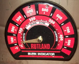

I just picked up a "new" style Rutland magnetic thermometer at "Menard's" to replace my old magnetic one, and its built quite well for $7.99, I had the similar "free spin" problem with my probe thermometer, so I disassembled that and "repegged" the dial after calibrating it.
I have both in use generally, as well as a remote probe oven style electronic thermometer attached to my stack with a S/S 10" hose clamp, for a audible warning that I can set based upon what Im looking for in Flue temp.
  • [Hearth.com] stove thermometers
