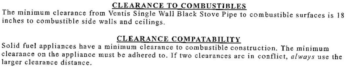

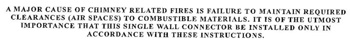

    Response from Heatilator support -
    We do not manufacture the pipe. If there are different clearances for that pipe then you must follow per their instructions. In the manual it does state to * SEE PIPE MANUFACTURERS CLEARANCES - NOT TESTED*
    DuraBlack -
    IMPORTANT DuraBlack must be installed with at least an 18”" Clearance to Combustibles
    Excel -
    EXCELPrime 18”" Clearance Stove Pipe - 18”" clearance minimum - A MAJOR CAUSE OF CHIMNEY RELATED FIRES IS FAILURE TO MAINTAIN REQUIRED CLEARANCES (AIR SPACE) TO COMBUSTIBLE MATERIALS. IT IS OF UTMOST IMPORTANCE THAT THIS CONNECTOR BE INSTALLED ONLY IN ACCORDANCE WITH THESE INSTRUCTIONS.
    Selkirk -
    SAFETY - Saf-T Pipe must be installed with a minimum of 18”" clearance to any combustible surfaces or materials
    IMPORTANT: A major cause of vent related fires is failure to maintain required clearances (air spaces) to combustible materials. It is of the utmost importance this Saf-T Pipe be installed only in accordance with these instructions.
    Ventis single-wall
    Screen Shot 2018-06-25 at 10.26.07 AM.png Screen Shot 2018-06-25 at 10.24.23 AM.png

    Ok well i have to question all of hhts clearances then. Because if they dont test their stated clearances how do they justify them? When i talked to our regency rep about the issue they said yes the clearances were tested using approved ul testing procedures and that legally they cannot publish and clearances which are not tested because they are selling a ul listed product.
    In comparison durablack excellprime saf-t pipe ventis single wall and most others are not ul listed and all of their instructions refer to the 18" requirement as stated in nfpa 211. And we all know nfpa 211 clearances are overridden by manufacturers instructions.
    Now if heatilator says their clearances are dont overide then clearly they dont in this case. But then why did they publish that manual with those clearances?

    Very good question. I asked if HHT would assume liability if there was an issue and got no response. Ventis states it most clearly. When there is conflict between the two clearance requirements always use the larger clearance distance.
