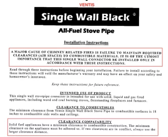

    So just ignore the pipe instructions and code?

  9. begreen
    begreen
    Mooderator 2.
    Staff Member
    Nov 18, 2005
    75,635
    11,826
    South Puget Sound, WA
    So you ignore Ventis's explicit instructions and install according to the stove instructions instead, correct?

  10. bholler
    bholler
    Chimney sweep 2.
    Staff Member
    Jan 14, 2014
    16,959
    3,824
    central pa
    What did i say i do here many times? I use doublewall in that case. Infact i used double wall for anything under 19" or 20" But by code those ventis instructions mean absolutly nothing because they are for an unlisted product. And that stated clearance has no basis in reality because it was not tested. The regency one was.

  11. begreen
    begreen
    Mooderator 2.
    Staff Member
    Nov 18, 2005
    75,635
    11,826
    Then we are both in agreement. In spite of the stove mfg. saying a closer distance is ok for single-wall we are not comfortable with single wall pipe being that close to a combustible surface.
