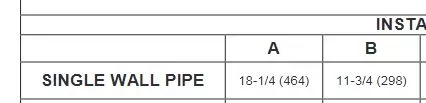

    For one it would be none other than the Quad 3100 Millenium
    Capture.JPG Capture2.JPG .
    Shown as 18.25" to the center.

    Can you find any others? I'm confident there are some. It is a manufacturer oversight IMO.
    B365 - 4.2.1 Manufacturer’s certified instructions
    Certified appliances, accessories, components, and equipment shall be installed in accordance with the
    manufacturer’s certified instructions. When a difference exists between the manufacturer’s certified
    instructions and the requirements of this Code, the manufacturer’s instructions shall take precedence.
    Note: A flue pipe is not considered a component of a certified appliance (see note to Clause 6.4.7).
    B365 - 6.4.7
    The minimum clearance for a flue pipe adjacent to a combustible surface shall be 450 mm (18 in),
    regardless of whether the surface is covered with noncombustible material such as plaster or cement
    board. See Figures 3 to 5.
    Note: The flue pipe clearances shown on wood stove certification labels are for information purposes only and do not supersede the clearance requirements of this Clause.
    In Canada there is no question about this. Ulc s627 is our standard and it is an appliance testing standard, not a flue pipe testing standard. To try to blur the lines of appliance certification to potentially compromise safety is foolish.ymmv in the USA, but I would never recommend installing a single wall flue pipe closer than 18"s to combustibles.

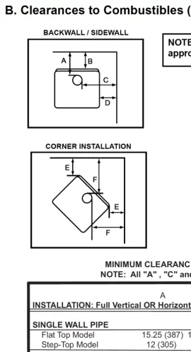

    Very interesting, That's from the same HHT documentation dept.. They need a review of stove pipe specs. Here is the original Quad Millenium 3100 doc diagram. Note the clearance A.

    You are right, the popular F2400 does this too. What does a Regency installer do in this circumstance with a single-wall stove pipe installation? Follow Regency's manual or Ventis's explicit instructions? It would seem that violating the stove pipe mfg. directions would void the pipe warranty and place liability on the installer if any issues arose.

    It is the same dimension but to a different spot. Add 3" for half the pipe and you get the same 18.25"
