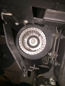

Hi everyone,
I'm in my 3rd year with my Enviro Boston 1700 insert. Recently the fan will start making a very strange sound - it's louder than the base level but not too loud. It sounds a bit like the gates of Hades opening up. Kind of like a throbbing / rattling "ReeeeeeReeeeeawwwwwRedrumRedrum" sound. Freaked out the wife first time it happened.

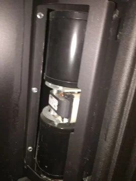

I've noticed that it stops if I change the speed and the set it back. I haven't done any maintenance on the fan except poking a vacuum rod in to pull out dust every now and then. I can get the top squirrel cage but it's not the most accessible thing in the world.
Any idea what it could be and what things I should be doing to maintain the fan or fix this problem? Seems some disassembly is required for anything more than surface dusting and I don't want to pull it apart without knowing what I'm doing.

Probably need to remove the fan assembly and do a complete cleaning of the fan and try to spray the bearings if you can get to them. Not sure on the Enviro Boston 1700, but typically fan assemblies in general are not the strong point is most inserts.
Try using an Air Duster. Those fan blades have loads of dust on them...somewhat on one side....and that could be throwing it all out of balance/making noise.
good luck
That was a before picture. It's pretty spotless after cleaning with the vacuum - I did also try the canned air on the bottom since I can't reach it or see it with taking it completely out so I don't know how well I got that.
