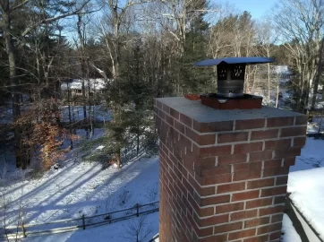

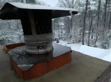

Just took a drone up to the cap... looks clogged to me as I can,t see any daylight. Thoughts?
That would definitely cause smoke to back up!

The cap is a pretty standard (I think) non screened, single flue cap.
Guess we have different definitions of 'non screened'!
Overall, that is a fairly poor cap design. That screen won't stop sparks / embers but will continually get plugged - as you can see.
A professional cleaning with some actual 'cleaning' would help. But my experience has been the screen can stay fairly clean but one accidental smoky fire (something like the stove failing to stay in a good burn when you go to bed) can plug it up pretty good.

Solved it today with a brush from the bottom.

I’ll get on the roof when the snow is gone and give it a proper scrubbing. Thanks for all the help.
Clever way to inspect. As noted, there definitely is a screen in it. Looks like the stove is running too cool. Primary suspect, poorly seasoned wood. Is the liner insulated?
