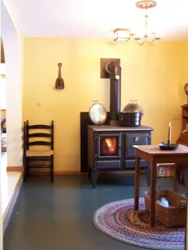

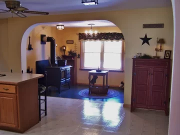

Hello Matt,,, I have owned an Esse for 2 years now,,, the fire box will take up to a 19 inch long split... Yes it will burn over night with the wood box option.. To use it as a primary heater,, yes you could,,, but we also heat with a Woodstock Fireview Cat stove... For your primary heat source I would say to go with the Progress Hybrid with the built in cook top, if you want a cook surface... We do love the Esse ,wouldn't be without it now that we own a cook stove...You will tend the Esse more then a cat stove,,,I would say if you are going to use it a lot for cooking then you'll have the best of both worlds, heat and cooking... it is nice to have a preheated stove top or oven always ready and waiting..... if your are only going to use it for a heater, that's a tough call,,, myself I would look at a cat stove with a cook top. Here's a picture of a typical load of wood the Esse can hold and what you'll be missing;lol

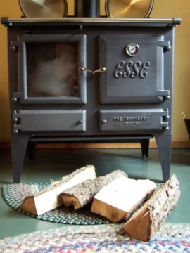

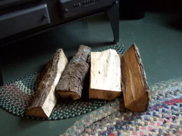

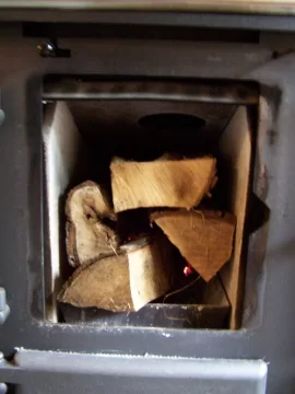

Charly, GREAT pics, thanks! With those 4 splits loaded, what kind of burn time would you get out of it?

That's funny, I have mentioned that to them. Right now I burning silver maple so she'll go about four hours and then be in the coaling stages, that's with the secondary draft half open...I like to burn it hotter to keep internals clean that surround the oven. Hardwood your can go an easy 6 hours plus... Let's put it this way,, there are always coals to add more wood in the morning. The Esse is not a stove you want to let go out and start cold all the time,,, your heating up a lot of cast iron in the top alone plus all the steel around the oven , etc. You get the stove cast iron top reading 400,,, that baby is pumping out some serious heat.
