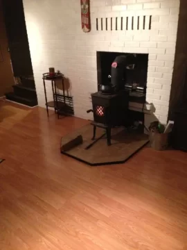

Jotul F602 CB. I have one and I love it

I love that jotul F602B. Any approximate costs for this one?
Last i had checked they were about $1000, but that could be off. I can't remember if that was enameled or painted. Call your local Jotul dealer and let us know.

I paid 750 for mine at a local dealer. I got lucky and was able to snag the floor display model.
It's painted cast iron. I have been burning this stove for three years and she still looks new. It likes small hot fires and seems to burn clean. The dealer recommended 500 degree stove top for the cleanest burn.
I had to install a damper in line, due to my high chimney. I imagine it would perform even better with a shorter chimney.
