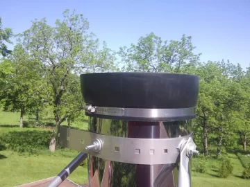

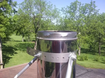

I have 6" Selkirk double wall class A insulated chimney sections. This cap has a inside ID of 8 1/4". It fits perfect over the chimney pipe. The hose clamp snugs up the cap right under a ridge on the chimney pipe. It won't blow off.

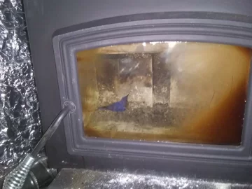

Yesterday I had a bird in my stove. I was able to get it out by covering it with a towel. The bird did not struggle too much. I let it go unharmed outside.
By chance the Fernco cap arrived yesterday, so I installed it. It is just what I wanted for my needs. Perhaps this will help someone else.

I would much rather let some air move through the chimney

That means you will have condensation in the chimney unless you completely seal top and bottom. An add quite a bit of dessicant.
