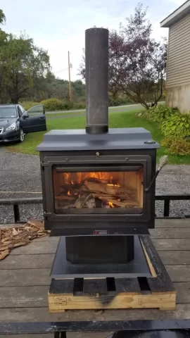

First burns in the driveway today to season the new stove...

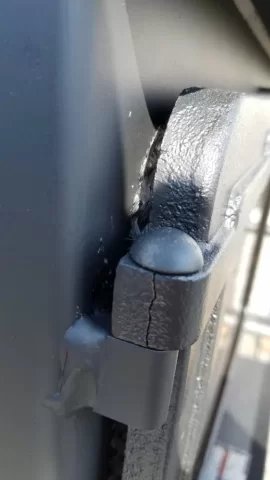

Found a crack in the ear on the cast iron door. Called customer service and waited on hold for about 20 mins. Not a big deal, and they are sending me a new door. Found the experience to be quite painless. I will have to install the glass from the old door and a new gasket on the replacment, which Englander are providing. Overall a satisfactory customer service experience, compared to when I called Harman about burn issues.

I never did a driveway burn for any of the 5 EPA stoves iv purchased. Iv found that a breakin with small low and slow fires produced very little if any initial smoke from the outside of the stove. Now ill be checking my stove door hinge for cracks!

Found the crack prior to the first seasoning burn per the manual.
As far as seasoning goes...I burned off the fumes for the last 2 stoves on the hearth. Smoke alarms went off on both. Gonna do it the smart way this time.

Yes you have to ramp up the temps really slow if you dont want fumes and smoke. probably driveway burn offs are safer for most.
So...finally a chance to update my experience so far. New stove door arrived...complete! It had glass and gasket.
Plus an additional larger gasket. With gasket cement...!
Took defective door off and installed the new one.
