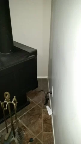

Thank you very much guys. This is all great advice. I do as well run the blower all the time as I find it helps to heat my 1500 square foot bungalow. I attached a picture where I am taking my temperature reading from. I have been scared to over fire my stove. I brought an ir thermometer home and that seemed to be the hot spot. Madison thanks for the advice on the spring burn to clean the stove out. All advice is greatly appreciated. The wife an I love having the stove.

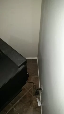

The angle of the pic must be deceiving but the clearances sure look tight? Maybe at least take the piece of paper/tag off of the blower cord to satisfy my OCD. Lol.
Thanks for the advice I love this site. Tons of information and great people. Those worried about my clearance I have 8 inches from each corner of the stove to the wall. 5 inches is the required.
