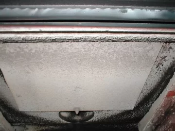

Summit top flame shield if this is the one your referring to?

Yep and mine is in there if memory serves me right, I checked when I cleaned the baffle, Hog-I read your post in the full box thread and I could never load that big of Oak splits and get it to burn that well , I think my wood is as dry as I can get it in Iowa, the Green Ash is at 13 to 15% and my 3 or 4 year old (lost track) small splits of Burr Oak is at 16%. I wish now with all the time off for xmas I would have just bought 4 more feet of chimney pipe.

Yeah, that's called the "non cat insulating shield". Ducking for cover. :lol:
