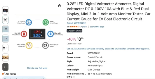

You should have a way of monitoring your 12V battery voltage. On mine I inserted a little meter that reads DC amps and DC Volts.
There is no voltage meter in this system but I'd like to add one. Not a bad idea.
