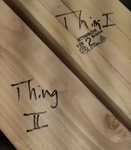

Went to the homestore today and brought home two of 4x6x96 S-grn Doug Fir.
Thing 2 is particularly twisty, has been on the racks at Team Orange probably a while and is easily several pounds lighter than Thing 1. Thing 2 is for later.

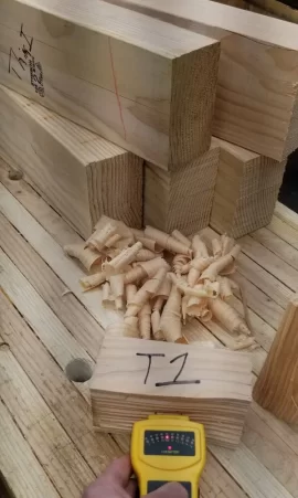

Thing 1, today's topic, feels about right for weight as a fresh from the mill S-grn Doug Fir 4x6. 18 inches was cut off one end twice, then a 6 " scrap cut from the middle of the plank, with the remainder of length cut into 3 pieces 18 inches long.
The six inch scrap was split roughly in half. The freshly exposed face felt damp to the touch, and with pins inserted parallel to the grain, the MC measured 21% (wet basis) at 55 degrees F.

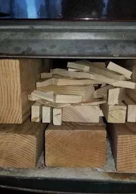

Preparing to load the cold stove, author's opinion, this wood is too wet for my stove to run good, and this is a LUDICROUS amount of kindling to deal with at every cold start. From an operational perspective (with no instrumentation to collect emissions data), this is clearly suboptimal fuel compared to softwood at 12-16% MC wet basis.

I will now go load all this into my cold stove with one eyebrow already reaching for my hairline. 20% MC is a minimum, but it isn't optimum for anyone I know of that has run a little fuel at 16%.

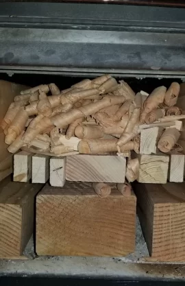

First the full length pieces were loaded. The 5 # of kindling on the load bill does include 6 of 1x2 furring strip at 18". Then the kindling smalls, and finally the plane shavings.

I used two seasons worth of kindling, or thereabouts, on one cold start and cut a solid one minute off my previous personal best cold start to clean plume time. Air intake was at wide open throttle all the way through.
T + 8 seconds - audible draft in chimney. That was super quick for me.
T +90 seconds, loading door moved to just cracked open, no visible stack plume (yes I ran out on my deck barefoot at +12dF to go look.)
T + 3 minutes, loading door latched, exhaust gas probe at 200dF. Also quick. All that kindling did get this burn off the line fairly quickly.
T +5 minutes - visible plume, 400dF exhaust gas temp
T + 9 minutes, 450dF exhaust gas temp, cat probe indicator lifted off the low stop
T +17 minutes 1100dF exhaust gas, cat probe half up inactive zone
T +20 minutes, 1200dF exhaust gas, active zone, combustor engaged
T +21 minutes, clean plume
21 minutes ET to clean plume, minus the 90 seconds at the start of the burn with no visible plume, means the smoke police, maximum, might have seen a visible plume for 19.5 minutes, a legal cold start inside the 20 minute regulation local to me.

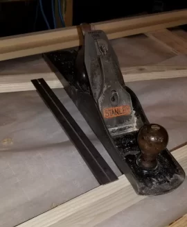

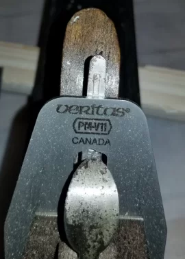

Please tell me about the plane you used!
#6 Bailey. I think it is a type 11. Sorry, I am not a type number snob. We have a bazillion type 13s floating around up here thanks to FDR fixing the price of gold - too low for local miners to make a living. I recall type 13 was 1931 to 1933, but that is the only one I am reasonably sure of. A bunch of gold miners up here put down their picks and tried their hand at wood working to feed themselves, judging by what I see on rust hunts.
Any road, pre type 13, I found it loaded with manure at a really good price because it was FOS and the 'not desirable' #6 size. I used a hoof pick to get most of the manure (horse I think) out, and waited for my wife to leave town for a weekend to get busy with naval jelly. New iron in PMV11 from Lee Valley honed to 4k diamond at 30 degrees secondary with a Lie-Nielson guide on DMT stones, I was able to save the factory chip breaker. I set it up as a panel plane.
Whoever the previous owner was, his wife or kids hated him. She might have hated the horse too. Happy to take it to PM if you have follow up questions. I have, at last count, 10 Bailey type planes under my bench, nine of those legit vintage Stanley Bailey's. I am hooked on PMV11 and not buying anymore A2 irons if I can help it. I look at O1 as basic, PMV11 as an upgrade when I can afford it and only buy A2 when I have too.
Actually, the orange paint on the cap iron suggests my #6 is post WWII. I just took a couple pics. I have a mild preference for the earlier 'low knob' types, but I really don't care. Sharp, it has been said, solves all manner of problems. I have recently brought in a DMT stone at 8k now that I am moving into hardwoods, but 4k as my finest stone served me well getting moving with softwoods. 12" steel rule for scale.

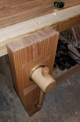

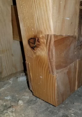

The vise chop was one end of a S-Grn Dour Fir plank, currently 33 x 3 x 11 inches. It came off a plank 16/4 x 13 x 108. The other two thirds of the original plank were crosscut to 3 feet each, and then ripped on the center of the grain lines. I ended up with four legs for my next workbench, a pair of 4x7 and a pair of 4x6, each 36 inches long. They are FOHC, free of heart center cut, stickered in my shop and waiting for their turn on the dance floor.
So S-Grn when I started. When I was rip sawing the legs apart I smelled turpentine, a pretty good indicator DF is at or above 20% MC wet basis, and when I stuck my meter into the freshly exposed face I found mostly 20% with 21% indicated here and there.
Second pic shows the vise chop, the vertical piece that moves back and forth, is still shrinking. I put all those bowtie shaped pieces in while the original plank was still full thickness with parallel sides. Then I planed the surfaces flat, cut the tapers and planed the tapers flat, and you can kinda see the lower bowties are now a little proud of the previously planed flat surface.
