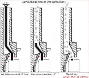

What are the inner dimensions of the clay liner? If it's too big, draft will suffer and running the stove will be a fight. If you are in it for the long haul, I would consider just biting the bullet and putting in a stainless liner. Performance and safety will be good, and they are easy to clean yourself with a brush and rods. Not a lightweight, but a heavy-duty version. Sure, it will cost you up front, but you will be all set then.

That's a small enough clay liner that draft should be OK with a direct-connect setup. Pipe has to go up into the terra cotta section. It's a PITA to clean though..might have to remove the stove. To get a 6" insulated liner in there you would have to bust out the clay liner.

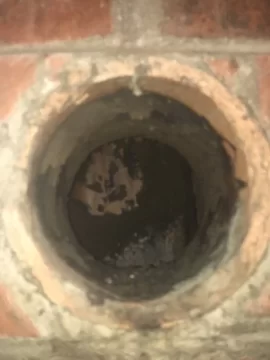

These are some pictures of the chimney I’m going to be utilizing with the new stove. With the wall cap off, I can look inside the chimney and it’s approx 6.125” round id terra-cotta from living room to inside chimney, stubbing into the 6.5”x6.5” terra-cotta chimney liner running vertically. Soooo, my question now is, after the inspection, if the terra-cotta checks out good, what’s the best way to route the liner? I’m a DIY kinda guy, if I can save a buck myself I’m all for it, and I’m ocd perfectionist so I’ll be sure to do it right. Should I go vertically the entire length of the chimney with the liner, and a T to connect out of the chimney to the stove with black pipe, and run the liner down to the basement near the cleanout? Or could I go liner to a 90* out to the stove? I realize the second means pulling the stove for cleanout each year

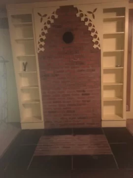

  • [Hearth.com] Super newbie, basic help appreciated!
Just to be clear, the brick face is approx 36” give or take a couple wide, and about the same projection on the hearth out, which is all red brick trimmed out in HEAVY slate, if that helps anything at all. Sucks cause I could fit a big stove on that pad, but limited to 6” flue
