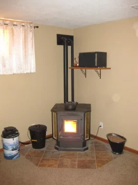

I live here in Missouri, It is not warm weather country( in my opinion). It gets fairly cold and most of all wet (last night it was 18 degrees and 76 percent humidity)After having one I don't consider that heat pump weather. My house is 2850 square feet and I installed an older 2001 model used Englander 25 pdv pellet stove (advertized at 48k BTU) Like Steven F my house is all electic with an air source heat pump and electric back up heat strips The heat from this sucks and always feels drafty when it is below 40 or so. With this pellet stove installed in my finished basement and only gravity (up my stairwell) it heats my house pretty well and feels a lot more comfy. 2 winters ago in our WARM climate it was 10 below for days and it kept my house at 69 degrees. I consider this good for such a large home. Granted I was burning 3 bags of pellets a day. This is a picture of my installation I exited a concrete wall so I didn't have to go through the ceiling. It just seemed bad to enter the floor joist cavity with the flue. Go pellet stove in the Midwest if you don't have a fuel type heat you will not regret it.
