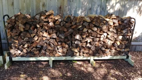

Bought my first ever face cord of seasoned red oak and built a rack made of 2x6's and 2x4's with some metal braces on the sides. It was tricky trying to determine where to put that wood where it wouldn't attract extra bugs into the house or kill grass underneath it. I ended up stacking it in the back of the yard under some pine trees already covered in pine bark mulch.

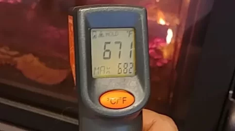

Burning the oak has been great. I can throw in a couple logs at 10PM and wake up 7 hours later to find a few embers left to start it back up. What I never expected though was how well you can make pizzas in this thing once the fire dies down!
This is just the temp of the glass. The embers are so hot the thermometer can't read them. Ouch!

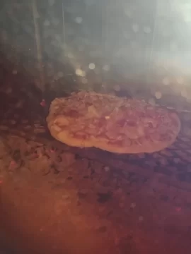

Once two to three logs' worth of embers are prepared they get pushed out to the corners for even convective heat. I made a tool to reach in and pull the grate down with some scrap wood, then use a standard aluminum 14" pizza peel to quickly get the pizza in.
[Hearth.com] Supreme Fusion 24 wood insert
This was my first attempt and boy is it hard to get the camera to focus in there!

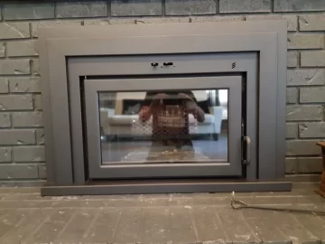

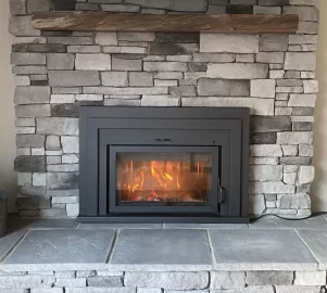

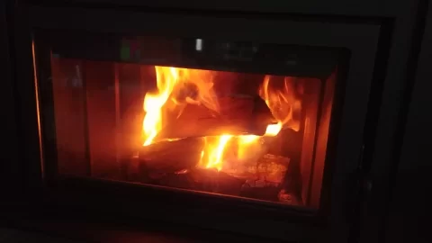

Looking for some advise with our new insert. Had the Fusion 24 a couple months now, installed by a local dealer. Single story chimney with insulated ss liner. Burning dry hardwood.
Its pretty to look at, but our unit has been finicky to operate. The automatic air control just doesn't seem to let enough air in. Once the fire warms up, the automatic damper starts closing. On many starts the damper will close before the kindling has time to light larger pieces of wood. Should mention, to my knowledge the activator/damper lever can't be manually pushed back in until the firebox cools. I also have the burn rate selector set to maximum burn rate.
I'll crack the door long enough for the fire to get going usually exceeding what the owners manual says (shut the door after 2 minutes), but even leaving the door cracked 5+ minutes like the op suggested and getting a pretty decent fire, when I shut the door in seconds the fire sometimes goes out. Twice creating a lot of smoke and back drafting. Any suggestions to prevent this? I'v tried loading the wood lots of different ways, crack a nearby window, using fire starters etc.

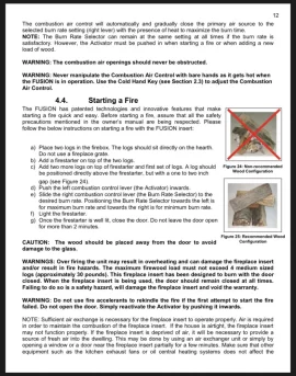

Looks like a nice install. I think supreme says not to use kindling because the fast heat from the kindling will heat up activator to quickly causing it to close prematurely. Once you get it going how’s the heat output and burn time ?
Think you are right. I spoke to the Supreme, very nice and helpful on the phone. They said use a long burning firestarter (specifically Pine Mountain Starter Logg) with the logs set up just like that photo in the owners manual with NO kindling or paper. After lighting the starter shut the door immediately. I'm picking up those starters and giving it a try. Basically they were like this is an EPA stove with 5 patents and doesn't work like your old stove.
If I still have problems they said to better secure the liner connection at the unit.
I had the exact same problem with the fire extinguishing itself at first. Your firewood is likely split too thick, to the point when the 'starter burns out the wood can't stay lit. Use thinner pieces, especially on top. They will turn into coals first and help light the wood below. You could also mix in some lower density wood, which burns faster and more easily. Once you get a feel for it, the auto air control truly is automatic.
I'm just using my small homemade starters (3oz dixie paper cup + shaved wood hamster bedding + 30 grams of candle wax). One is all it takes. One other tip: if you need more depth for longer firewood pieces, remove the BBQ grill. Adds about 1.5".

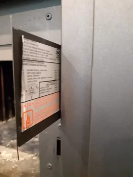

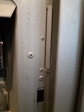

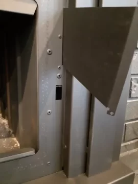

I recently had an 18 installed and have had no issues with it so far, but, I do have a question that I can not find any info on.
On the right side where the door latches is a metal plate that has a 45 degree bend in it and pulls out of the side.
I want to guess thats it an ash scoop..... Anyone noticed this?
