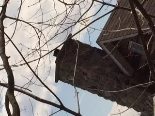

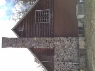

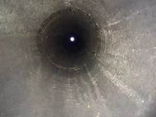

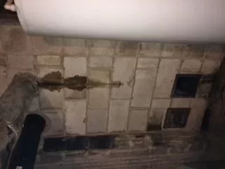

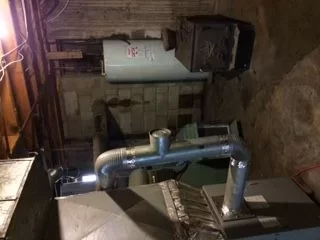

I uploaded some pics...
Thanks for your time

From those pics i cant tell what the construction of that chimney is but I can tell it is not the round center blocks. Regardless i can see cracks in what ever is there so it needs lined. Smaller diameter will increase draft to a certain point than it will start to reduce it again. The thing an insulated and properly sized liner will do is that it will stabilize the draft and make it very consistent. Another thing i see is that your furnace is positioned wrong the vent pipe is way to long and has way to many elbows in it this will add to the buildup of creosote. Which i can tell has been an issue from the creosote stain running down from the crock. What ever you do make sure you have the chimney cleaned very well before installing any liner. If these guys do not typically insulate liners i would not count on them properly cleaning the chimney first either because they are already cutting corners. I am also pretty sure i can see framing in contact with the masonry there which means that by code you need to have the liners insulated.
This oil furnace will be replaced by the max caddy, it is last owner's installation... duct are also really badly installed... :- |
