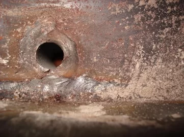

Here are pictures of the hole from my old Pacific insert. My new Super insert also has a similar hole. It goes right through the firebox. If you lift the boost manifold, you will see it.
As the other posters have stated, I think it is there to maintain the burn to EPA standards.
  • [Hearth.com] T5 burn time and damper issues update

This I think is the dime sized hole that they are referring to. The T5 does not have an EBT but has a similar firebox construction to the Pacific and Super, minus the ash pan.

I have never plugged mine either and I do get good burn times. But the plugging the hole might enable more control (ie. ability to shut down a runaway fire).
My thought was it might be compensating for some thing else, I hope some PE expert chimes in here.
I believe the difference in burn time and control between users is all in the wood. I'm running desert dry Ponderosa and need to shut the air way down to keep the stuff from going POOF. If I load the stove with some wet maple, I would not need to plug the hole and probably open the primary air a bit. The hole is just additional primary air to keep the stove from smoldering, I'm sure there's an engineer out there who thought this was a good idea, but I would really rather have control over my stove than save the planet from a 2 cords a year worth of smoke. My plan is to make an adjustable flap to cover the hole that will move with the primary lever.

The primary air control is completely separate of the hole. This is simply a hole in the firebox without any controls. When I first saw the hole, I put a screwdriver in it and sure enough it came out at the bottom of the firebox.
I am not sure if the T5s' etc. primary air controls fully closes all the way or not. Those that have sealed the hole should be able to answer that. B
The T5 primary is the same way. It only closes partially leaving about 15% of the adjustable hole open. The other hole in question is always 100% open unless you stuff some tin foiling there. On my stove I modified the primary air control to close almost all the way and also stuffed the bonus hole.

I spent all last burn season and 2 months this year trying to track the problem down. Never found anything wrong other than the engineering and I understand why it's designed the way it is, but sure don't appreciate the inability to make needed adjustments. Last thing I wanted to do was modify my brand new stove. I made very small mods thru November trying each out for a couple days before moving forward. Until I saw this thread I thought I had done all I could do, but now with the "tin foil resolution" it's almost perfect. It will be perfect when the primary air adjustment works on both holes.

Yes, I used a bar chain file to remove material from the sheet metal in front of the air intake as well as the mild steel stop. I stopped removing material when the lever stops with 1/4" of the primary hole open.

Ash door is as tight as it is going to get. Dollar bill test is good. Door glass seal is good, I put dish soap all around the glass on the inside and blew compressed air around the outside with no bubbles. It's just the wood. If I burned oak or maple, I would not have needed the mods. The Ponderosa I burn is beatle kill dead and desert dry.

FWIW i just replaced some cracked fire bricks in rear of my T5 and recemented door gasket at upper left corner, while at it i plugged the dime sized hole with foil and am going to see if it makes any difference in burn times and fire control.. i love my stove and can get 9 hours burns with some coals left but would like a little more control of flue temps usually at 2 hrs into a full load my flue can read 450 to 480 with dry oak in stove.. we will see what happens.
