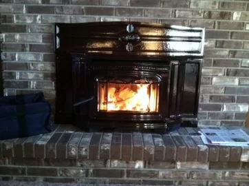

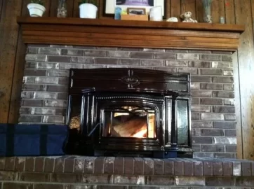

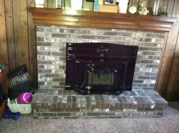

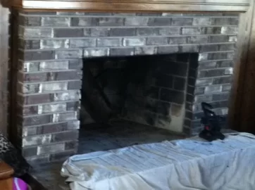

Finally got the insert installed today. :cheese: The owner of the place I bought it did the install himself along with his helper. Top Notch guys. I have a cape cod style house with a nasty roof pitch. Brian gets on the roof, straddles the peak over to the chimney & poof, he his sitting on the chimney. NO WAY !!! That's why I let the professionals do it. Basically a seamless install without any snags. Maybe 2.5 hours. It looks fantastic. I've had her fired up for about 3.5 hours now & lovin it. I will close the air flow down tonight before bed & see how things look in the morning. I don't want to get too crazy the first night. I definitly need to get a thermometer. I guess the question is where to put it?
Here are a few pics. It looks like my cell phone camera doesn't show the color real well but it is the brown porcelin finish.

What a beaut. I always liked that finish.

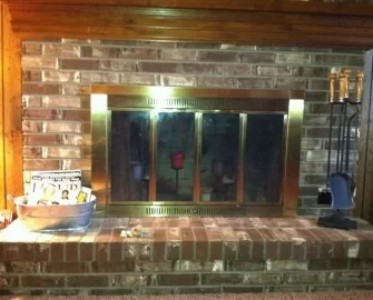

Very nice indeed. Really like the looks of the enamel... I was just laughing looking at
your fireplace doors...exactly like the ones I took down to put my insert in...ha
Let me know when you find a place to put a Thermometer...I even asked an got no
answer on here. Even using a IR isnt handy.
Nice looking insert. You are going to love the warmth this stove is going to through out into your house. You're going to ask is this the same fireplace we had before installing an insert?

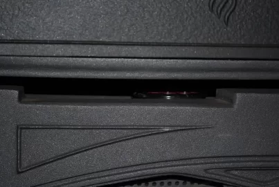

Put the thermometer between the opening where the air blower sends the air out of your stove. See mine as a reference. You will need a small flashlight to shine in there to see it.
How hard is it to see? I would like to have one as a quick reference.
What type did you chose? Condar/Rutland/other....

It's very easy to see when you shine a light on it. I use the two pins that stick up on the thermometer as a reference.
Edit - I have the Rutland

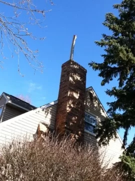

Is that a flex liner sticking out of your chimney?
Yes but still during the install. Spider man wasn't on the roof at that time. He cut the excess liner & installed a chimney cap.
mellow said:
Good looking install, I am sure the flex sticking out of the chimney is during the install, just no installer in the picture (probably getting it through the damper area when pic was taken).

By the way, it's not a straight up shot. The installer had to use a 30 degree elboe. The flue must be offset to one side of the chimney & needed the elboe to get to the top of the insert.
