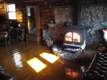

taking ownership of a Jotul Firelight Model 12
She's a beaut! Does it have a top-load door, or is the non-cat hardware in the way? I'd be interested to see the right side, back, and inside, if you have the time.
Several of us feel the way you do, and so I discussed this with Mark at Jotul, a tech who has been the company since they were still producing the Firelight 12. He agreed that it is one of the best stoves they ever made, but said that the reason for discontinuing actually had nothing to do with the design of the stove, and everything to do with getting the average consumer to run a catalytic stove without problems. Apparently, their number of service calls due to improper use or maintenance was much higher on this stove, than on any of their non-catalytic stoves. Also, there is an incorrect public perception that catalytic stoves are somehow troublesome or inferior to non-catalytic stoves, which I guess they found easier to join than fight. These were the reasons he gave me for Jotul getting out of the catalytic stove business.
Contrast that to those here, most of whom will admit that catalytic technology does build the superior heater, but the folks here at hearth.com are the exception. It's difficult to get the average consumer to even read the instruction manual.
Well, I'm one of those numbnuts that didn't read the instructions - properly. I just found this forum after wondering about the longevity of my catalytic converter, when I realized that I've been running my woodburner incorrectly since I bought it in 1993. The thing is I read the instructions, but having grown up with a wood burner, I must have thought I knew more than I actually did. Somehow I was thinking that a damper must always be open! I completely missed the point of the bypass damper and have been running the woodburner with the bypass open for 16 years. I never closed it to redirect to the catalytic converter, and I run my burner 24/7 during the winter months. I had to reread the instructions several times to convince myself that I was doing it wrong. I take pride in my woodburner, my logging and splitting, so it pains me to admit this.
So, when I got home today, I followed the instructions to the letter and, with the bypass damper now closed, the fire is burning away - not as hot as I would like, though. The front and top doors are shut as is the bypass damper (after I got the fire burning nice and hot), but now the fire is burning fairly slowly and not as hot as I would like, even with the air control in the full open position. I'm wondering if I have to start from scratch and buy a new catalytic converter. I haven't actually checked the catalytic converter yet and will have to wait a few days before I can shut down the burner to do it. Also, the rear plate is cracked and there is a significant gap - presumably from burning too hot?
If anyone has advice or words of wisdom on where to get a new backplate inexpensively and a new catalytic converter, I'd appreciate it. - call me humbled!

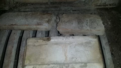

my stove never cracked but it destryed the back plate the inner back plate the grate lol look at these that came out however the stove shell inner and out is invery good cond. so
by putting new chamber , new steel cat ,, new inner back plate, and access cover and bolt , chamber cat cover , and bottom for chamber., new gaskets. It will be like new . the side plates and the whole shell is remarkably clean ! Its in great shape in fact this is the original cat in my hand and those are not cracks, the cat actually looks in very nice shape ,however i bought a steel one anyway to put in new chamber . Ihat was full time use 19 years of burning 6 months out of the year daily of somewhat green wood semi dry !. Does anyone have instruction of what to gasket im not sure?
1. i know gasket around the back of stove
2, under lid
3 under top cover ( does it only get 3 sides and none on back or complete 360 loop of 1/4 gasket ?
4 damper lover 1/4 gasket but ( do i gasket the whole flange also even though theres a gasket where that meets back of stove already ?)
5 on the inner back plate itself does this get a gasket when theres one on the back of stove already ?
im kinda confused of the exact placment of gaskets due to when it came apart the seemed to fall off and so cant tell the lay out . can anyone give a detail on where gaskets should go on each piece ??? would be very cool . I mean we will double gasket things if need be but sure would be nice to know its done per spec . :) Noooo more abuse to the stove ! Im getting a therm. so ill know temps and noooo more open ash door for lighting 19 years of that lol look at the grate looks like a bridge :( and the inner back plate had a 4 inch buldge as you can see :(
My damper has a slight warp but still able to go back on it might need thicker gasket to seal up the gap better . VERY THANKFUL FOR THIS FORUM. I didnt know these could be saved i was ready to scrap it untill i saw prices on new and how cheap the material has become . this forum has great info on it . Though id like to learn how to operate the stove properly with knowing what temp to close damper . i obviously ran it as to meet my need for heat over the proper proceedures

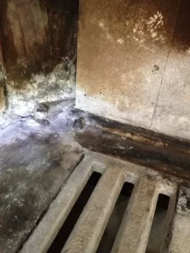

Jotul spec's 1/4" braided gasket for everything but the door glass, which is 3/16" braided gasket. Note that's braided, not woven.
The way you're ripping thru rear burn plates, and seeing your lower grate, you're really overfiring that stove. My 1993 stove had a small, almost invisible hairline crack in the back plate in 2011. I replaced it and have put at least 10 cords thru it since, with the rear burn plate still looking like the day it was installed. All of my grates are still as flat as the day they were made, and I'm putting a LOT of wood thru these stoves. There is no reason to have this damage, if you are using the stove properly.
One issue with this stove is that it can really take off in bypass mode. I find it only takes maybe 8 minutes with a full load of fresh fuel on coals in the morning, for the stovetop to reach 500F. In fact, sometimes I see external stove pipe temps hit 600F within 4 - 5 minutes, so I'm dialing back the air before I even engage the cat. The back plate damage is from burning with air open too far, or staying in bypass too long.
I've never seen a stove grate warped that badly, on a stove that's still functional. Have you checked all the seams between castings?

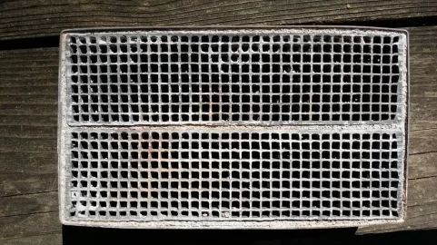

Hi - I'm wondering where you bought the steel cat cs 552. The lowest price I've seen is $199 without shipping. Also, could you tell me more about the 04-128455 cat cover. I'm having trouble reading the parts diagram and wonder if that's the soft foam-ish thing at the bottom of the inner back plate.
I'll post part numbers and prices tonight, but I bought all of these components once thru a local Jotul dealer, and then the cover and lower piece for the second stove from woodmanspartsplus.com. The cover is about $65, as is the lower filler piece. They're both made of a soft refractory insulation material.

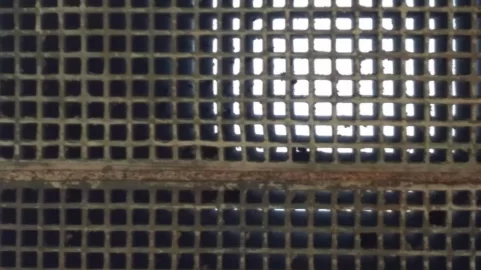

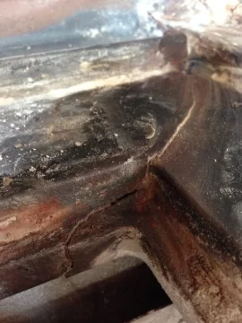

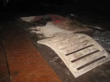

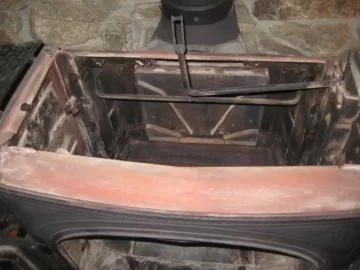

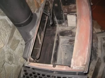

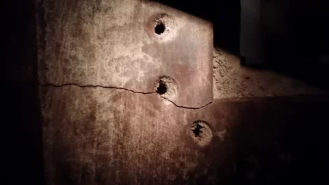

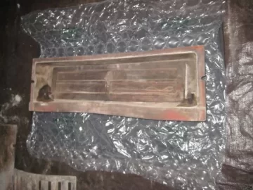

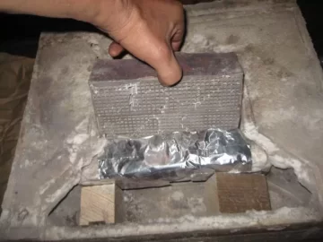

Other things I found that were wrong, and I'm wondering whether it is urgent to replace these, or if can wait until next year.
  • Crack on the inner burn plate(103329) [Hearth.com] taking ownership of a Jotul Firelight Model 12
  • Catalyst chamber cover (04-128455) is cracked, but not broken
  • Catalyst chamber bottom (04-128456) is broken in half but could feasibly be put back in place.
  • [Hearth.com] taking ownership of a Jotul Firelight Model 12
Lastly, how do you recommend I get the screw that holds the rear plate out? It's stuck pretty solid.
Again, many thanks, Maggie

If your talking of the bolt to the rear plate that covers the cat...your giving me memories... Mine too was stuck. Tried using a propane blow torch but ended up shearing the head off. I took the rear back plate out and then took it down to my local auto mechanic who got the threaded bolt out (relatively easy),
Soak with favorite penetrating oil, then remove with your favorite impact driver. Don't try to muscle it, lest you break it. That's the beauty of impact wrenches.

Any views on the other parts. Replace? or keep 'em?

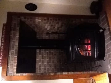

Hi all...new here and was looking to hear what ya'll think about the Jotul Firelight Model 12 wood stoves. My parents bought a house that has a big 3 car detached garage that they have no use for so me and my fiance are turning it into a 3 bedroom house for us and our 5 yr old and baby thats on the way and due febuary. It will be 2 floor and about 1900 sq ft once completed (about 3 months from now...starting construction tomorrow) We plan on heating primarily with a wood stove and my parents house came with this white Jotul thats in great shape and they have offered for us to have it because my mother wants a black colored stove instead of white. I personally dont prefer white either but hey its FREE haha! Figured I could always get around to painting it black later down the road. I have grown up around wood stoves but have no prior experience with a Jotul. Was hoping someone on here could fill me in on opinions of this stove and maybe known problems or advice on keeping it in good operating condition. Thanks for any insight anyone might have!
View attachment 100612 View attachment 100613
You could always add contrast with some black cast options like doors and black side warmers
