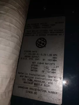

It’s a Burnham and yes leaking from the dis-used tankless dhw coils and around the faceplate. Suspect since it hasn’t been leaking too long that most of the corrosion is just sediment from the water accumulating and that the fasteners are in repairable shape. You never know till you try and you don’t try unless you know what you are doing.
We once had a family friend over who is a plumber and I was showing him the crazy labyrinth that is necessary to run two different water heaters seasonally. I pointed to a valve that looked in totally good shape and he he yells “Don’t touch that!!! Since you’re not a plumber you are only allowed to touch that twice a year, once when you turn it on and once to turn it off. Even better, call me and I’ll turn it for you”. Little does he know I turn all the valves once a month to make sure they don’t get stuck... but this is boiler thing is out of my league.

Crazy labyrinth? You ain't seen nothing. The blue tank came with the system and hasn't been used since I got the other tank. You got me thinking about draining the electric tank and maybe running it and the heat pump water heater, but I'm also lazy.
My boiler is a 2003 vintage Burnham boiler. I don't know how long those cast iron oil boilers can last.
Oooh, ya, that does look pretty crusty.

For the record, the coil plate of my old boiler looked more crusty than that for all the 6 years I owned it, but didn't drip when it was hot. I just let it stay hot all the time and never got it fixed.
Doesn't seem likely to be the sort of thing that will open up and cause a flood suddenly. I don't know if I would bother fixing it, and would just use the boiler for a few more years as is, esp if it doesn't drip when hot.
