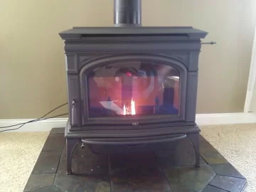

    For the $3K range you could look into the Lopi Cape Cod too. I Installed one last week, it was very cool! !cid__Photo781.jpg
