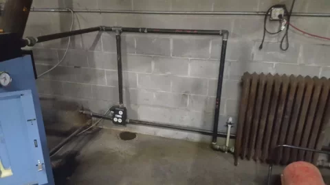

If you have 112 water going into the boiler, your return temp protection is not working. It should maintain 140 coming into the boiler. (actually that was already mentioned I think, but I'll repeat anyway for emphasis). I think you need to fully clean the boiler for starters, having return temps that low will build creosote - especially combined with wood that isn't dry.

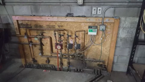

More pictures of the whole thing might help. You should be able to get on top of this.
I definitely have a return temperature protection problem. I got 160 at the top of the tank and I still have 120 going into my boiler

How bout a close up pic of the loading unit & dials while you're burning? Looks like its plumbed right.
Also, what's up with the cast iron rad? Looks like all your boiler flow is going through it? Unless I'm not seeing right. That would strip some heat. And make that room pretty warm.
