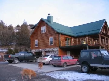

Here's some more info. I'm hesitant to move the chimney for a few reasons. The house has a steel roof and I'm afraid that I won't be able to patch the new hole and match the roof on the inside and out. I'm sure the steel has faded and the knotty pine on the inside has darkened. There is also a square structure the chiminey passes through on top of the roof. I've attached a picture of it. As mentioned by a previous poster, the ice and snow builds up on the roof and comes off violently. Moving the pipe would result in a tall pipe in the front of the house. The pitch of the roof is steep and doesn't the top of the chimney have to be above the ridgeline a certain distance?

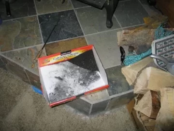

I got a chimney brush and cleaned the chimney today. I attached a picture of the creseote that came out. I'd estimate after four passes I got about a cup. It was pretty flaky and didn't burn very well when I put it in the fireplace after re-starting the fire. I didn't think that was too bad for 24/7 burning since January.
I keep creosote buildup swept out, would this be a safe installation?

OK, I hear you bro. I'm sure you'll keep monitoring the pipe. You are burning hot and clean and that goes a long way towards avoiding problems.
What a nice spot you have there. When the picture came up at first I thought it was a lodge.
The hell with the stove. I want your house!

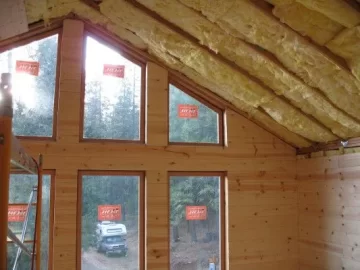

Like I thought, The same setup I have and the roofing is the same even the color. I wish I could do what you did but my gable end is all windows to the peak, would seem kinda dumb to block the upper windows with the pipe. But I like the box around yours and will probably do that to mine before a snow slide takes my chimney off. Bet you get some snow build up on that deck, I sure do and mine only comes from one direction.

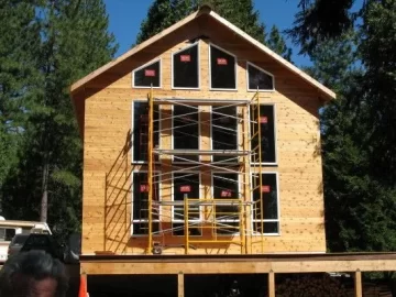

Very nice! although mine has trhe look its not logs, mostly a stick built. The only pics I have right now are during construction. You can see why I cant follow the roof line with the pipe as 555555 did
