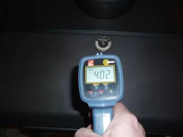

11:00 pm just put some wood in the stove, I want to go to bed and don't want to wait much longer. Loaded at 7:30 am and the stove was still a tick over 400* at 11:00 pm. I only tossed a half load in so I'll have room in the stove tomorrow morning since I loaded so late.
Picture of the coal bed and stove top from about an hour ago.

I have the t-stat below one..I know the flapper is shut and will probably stay that way through the whole load.
Anyways after I loaded it and charred it for maybe 15 mins the cat probe was at 2/3-3/4..stove top around 500f.
Then maybe a half hour 45 mins later the stove top went to 600f with the probe just about all the way...lots of off gassing going on and the cat is pigging out.
Then another 45 mins goes by and she is not off gassing so much and the temps are headed down for the low cruise.
I just went and looked and my IR says 450 by the cat probe and the probe is around 2/3 again..it will prolly drop down to like 350 stove top in a few more hours and stay there for a long time.
