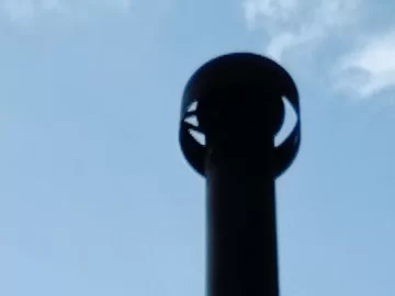

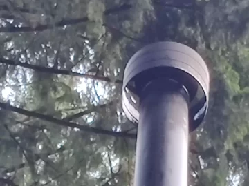

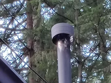

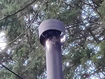

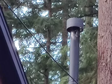

Do you have any more pictures of your chimney? I don’t recognize that cap. What brand is it?
I've no idea. Someone would have to take the top two sections of the pipe down to get access to it. I have a feeling it's likely the source of the problem.

I'm looking at the invoices and they don't show the pipe brand or the cap. Plus, I think at some point they switched the cap when they were trying to address the poor draw.
Can you get a picture of what you’ve got from the roof up?
Attached are those photos. Thanks for your interest and willingness to look at this.
