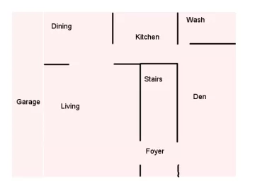

The room with the fireplace in it is actually fairly small. It's definitely supposed to be a den and it's tucked behind the stairs with doors to the foyer and kitchen. Heating this room would also let the heat up the stairs, but it might not be the best configuration for the first floor since the heat would have to pass through the foyer (or kitchen) to get to the dining room and living room. That being said I would be hard pressed to put a freestanding hearth stove in that room and have any space left for most anything else.
As far as the blowers are concerned, I figured I would also end up running a box fan. And, given where the room is in the house, the noise wouldn't bother me.
The problem with freestanding stoves it hat my wife originally settled on a Jotul, which I had budgeted basically $1k for the whole project and the stove alone would have cost $2600. I belabored the board with many posts about how I would build a chimney since our house wasn't arranged for such an addition and haven't really worked it out with the where and how beyond knowing I can build it myself and up to code with parts from Lowes. I also priced out a basement install and after figuring that out I decided against it.
However, putting the stove elsewhere would mean putting it in the living room or the dining room. The dining room already hosts the air conditioner for the house (no central air or forced air) but it's also the room furthest from the stairs. The fireplace is in the den right in the middle of the far right hand wall. Drawing is roughly to scale. I am not an archatect nor artist.

Your floorplan is most identical to mine. From the living room i can see the insert through the two 6 ft doors of the foyer, which would represent a un-obstructed path for radiant heat. That being said, we use our blower constantly, and it appears to start a circular pattern of air movement through all the adjoining rooms,,,as your floor plan would also suggest when comparing it to mine. Our thermostat is located on the wall of what is your living room near the entry into the foyer,. Once we start burning it seldom kicks on, except early morning when the fire has died down. I work a swing shift and am an early riser when on days, so it is seldom that it kicks on. We also have an old pre Epa, which likely might be putting out near 400 cu. ft of air,,,( not certain of that ) I would suggest the largest blower you can get, if going with an insert. Of course a lot of that hot air climbs the stairs, however just the same, I believe the blower is responsible for a circular pattern of air movement.

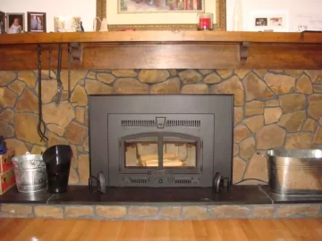

I heat 2300' with mine. Here's a pic!
  • [Hearth.com] The fickle whims of wives: She wants a lopi now
