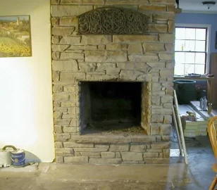

by the way -- a photo of the fireplace.

What do you think of the fireplace? The top is 42" from the floor and I have no choice but to use it -- that's where the friggin flue is !
No way I'm going to put a new chimney through the ceilng -- I have to make this work and besides the "setting" is meant for a stove. The guy before had an ultra UGLY fireplace insert in there, we busted it out with sledge hammers (mostly cast iron).
So, I have this opening and a 13 foot chimney (13 from top to the lintel).
Ideally, at first I wanted to put a smaller stove INSIDE the fireplace opening but that was poo pooed.
It would look great though AND free up my floor space.
I think that fireplace will look great with a stove in it! You can always add a pipe extension above the top of the flue. An extra 2 or 3 feet might make a big difference.
Do you plan on installing the unit in front of the fireplace? Niether the HT2000 or Austral is certified to be installed into a fireplace. If installed in front ...you definately need a proper venting system going up the chimney. EPA stove are so efficient they have much lower exhaust temps. They would both struggle to give you a good draft in a masonary chimney as you describe without a liner.
