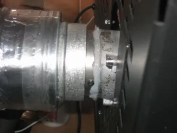

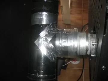

I can post pics for you if you want, Geek.
thanks pete, yeah let me see a couple pics of the cleanout T just to make sure I see how you placed the tape, in my case I covered the very bottom....
Geek, here's a couple of pics of my "taping & siliconing" job on the appliance adapter & T. Going to spray paint it all with the High Heat black when i remember to bring the paint up from the basement.

surprised to see you didn't need to seal the tee cap at the bottom.
No, never saw any smoke from there.....keeping my fingers crossed anyway. :blank:
