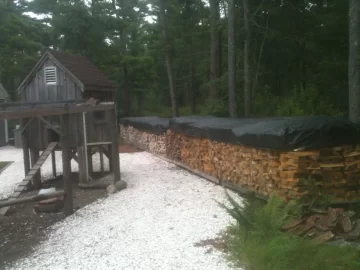

I used regular blue tarps the first two years but they did not last and fell apart after one season. Then last year I took remnant pieces of rubber roofing from the end of the rolls we sell and like it very much but it was still not what I was looking for.
Then this past winter I tried the wrap from lifts of lumber and found them to be very strong and easy to cut to size and at $0 cost you can't beat them. I now have five 20' pallets stacked and coverd with plastic trim board covers. They are made out of the same mateirial as the regular lumber traps but are made to cover 20' long by 4' wide by 1' deep pallets. Makes a nice neat job and cost again is $0.
I have also stacked the last pallet 1-2 splits higher in the middle row and it's working great at shedding off rain water. No puddles to blow off with the leaf blower that way. :)

Top covering looks good, but that's one righteous chicken coop!
I was thinking the same thing about the wood display and was wondering how it vents to let the moisture out. Only thing missing is a sign with a price per cord. He could be on to something here. Truly seasoned DRY wood as shown.
