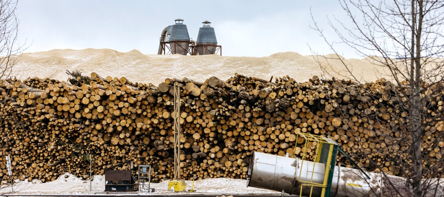

It sounded good to someone. Convert the coal-fired plant to biomass. The only problem is there isn't that resource in the country so England is importing it and taking down a ton of forest to supply these plants. They are burning 10 million tons of wood pellets annually. How is this sustainable or even sensible?
Its not. The fuel contracts for New England sales I have seen generally require an audit trail to establish that the fuel is a forest residual or pulled out of the trash stream.
Reactions: sloeffle
That answers a lot of questions, I had heard that Pinnacle had been bought, but didn't realize it was by Drax to produce pellets for their powerplant.
The areas that these pellet plants operate in are some of the areas hit hardest by the pine beetle, and if they are exclusively logging these trees then maybe this makes sense. Keep in mind these forests were the ones responsible for the massive BC forest fires of 2018, if some selective logging can remove the dry fuel in these forests maybe it's a good thing.
Eventually though this isn't sustainable, as high value timber will be taken for fuel, and Drax will need to find another source for it's pellets.
I think with lumber prices what they are, the writing will be on the wall for mass industrial pellet consumption. Timber sold for lumber will always command higher prices than timber sold for pellets, and North America is running out of land to log while lumber demand increases. Pellet production will get squeezed out. The unfortunate thing is households that heat with pellets will compete with government subsidized operations like Drax for fuel. IMO it makes more sense to burn that fuel in an 80% efficient pellet stove, than a 35% efficient powerplant half a world away.

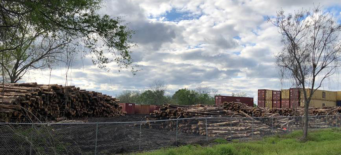

NC has been stripping clean, healthy, sometimes virgin long leaf pine forests for pellet manufacturing. Those pellets almost all end up in European converted coal plants. Enviva is the worst offender. The paper I linked below cites 50+ acres a day are being cleared in order to export wood pellts.
