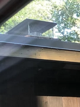

My next step is to figure out my chimney. I have a flat roof on my house so I’m going to be attempting to put a liner in myself and then connecting the stove when I get it.
Here are my thoughts and questions:
I’m going to measure the height of my chimney as I’m afraid it is not 15’. I’m guessing it’s 13 feet but will need to confirm later this week. I’m assuming 13’ is going to cause draft issues? It is an interior wall chimney but still plan on getting an insulated SS liner. Is this the right thing to do? I have a picture that shows what appears to be a liner already but I think it might be for my oil furnace. I’ll get a better pic this week when I go up and check it out.

The Castine likes a stronger draft. It might be worth revisiting the Hampton H300 with a straight-up connection. The Hampton will draft ok with the shorter chimney. The F400 might, but it may spill smoke if outdoor temps are mild (above 40º).
If push came to shove and you needed to extend the height of the chimney and liner you could get rid of the big cap and use a piece of Class-A with the proper adapter at the top of the liner. I suppose you could also cut a hole in the top of the big cap and run the pipe through it too.

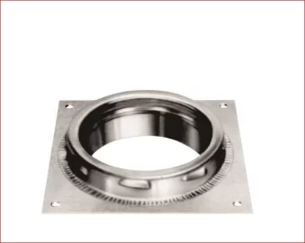

Insulated liner to an anchor plate, from anchor plate (1) 3ft length of class A chimney. You'll have 16ft.

I would cut the tile off flush and tapcon the transition plate to the top of the crown along with adhesive to seal around the edges and add a 3 or 4 foot piece, whatever you decide, and it'll be fine. Going up another 10 or 12 feet is a whole different setup.
I'm not fully understanding the cutting tile flush part that @HomeinPA is talking about. I assume a transition plate is the same as an anchor plate? And then sealed with silicone high temp... and adding a class a to the transition plate? I think the anchor plate that @kennyp2339 makes more sense and seems easier. Not sure which if those are the same ideas just using different names for one thing?
@HomeinPA is suggesting to cut off the existing terra cotta pipe that extends above the crown so it is level with the crown. This will provide a much wider purchase where one can anchor the transition/anchor plate. Looks something like this

You then anchor the plate using tapcon screws into the crown with adequate sealant to form a stable and secure base. Then the 3' extension pipe is attached and the cap put on top of that.
I see now. That makes sense. How would you connect the liner to the pipe though? Is it a clamp or a coupler?
You connect the liner the same way as you connect it to a cap at the end of the chimney, anchor plate has a male end the goes into the liner.. remember all ends face down so any dripping creosote goes back towards the stove and not leak out creating a mess.

Ok. So once the liner is in place I installed the anchor plate and cut the liner with a hack saw flush to the top of the anchor plate and then add the 3-4' of double wall class A pipe and then the rain cap on top of the double wall pipe?
I forgot to ask... is there a clamp that clamps the liner to the anchor plate so it doesn’t fall out of place? Does the class A just sit on the anchor plate and you turn it to lock it in place?
The anchor plates I've used have a male adapter on the bottom with a clamp to hold the liner secure. You pretty much need 4 hands and a nut driver to keep everything in place.
